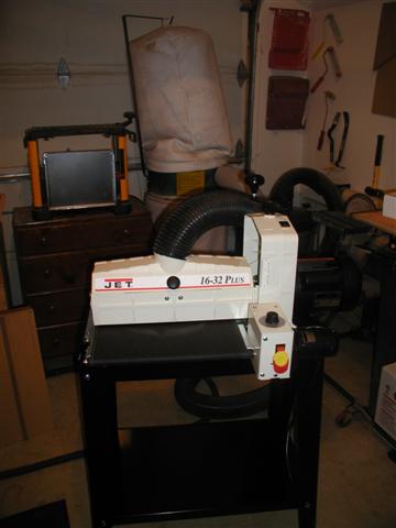

I went and did it this week - made up my mind and bought a drum sander. Got the Jet/Performax 16-32 from the local Woodcraft.
Today was set-up day. The drum was way out of parallel to start with, and I had to do the routine of loosening the bolts that hold the drum support assembly and use the adjustment knob. I found this to be a little fiddly, as it is hard to tell where the arm is going to be when you tighten things back up. I think I have it to within .003" from one side to the other now. I'd be tempted to try to shim the conveyor belt assembly if I wanted to get it any closer, rather than loosening up the main structure again.
If it stays where it is, I'll be happy. It's done it's first back so far. Here it is in the garage, in front of the Grizzly dust sucker.

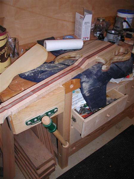

A couple of feet away is an electric bass, getting it's first body routs.

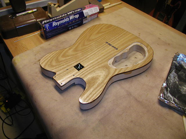

I'm trying my first Zpoxy grain fills today, too. One Rosewood OM that I finished last year and have never done the finish on because requests for other guitars got in the way. The second is a Tele, which I think looks nice as is (This is the back - it has a myrtle top) but is going to get a blonde finish on back and sides.

Jim nice choice. This machine is a real good sander. I agree with the adjustment setup and have used shims to fine tune my 22-44 Plus. Enjoy!!

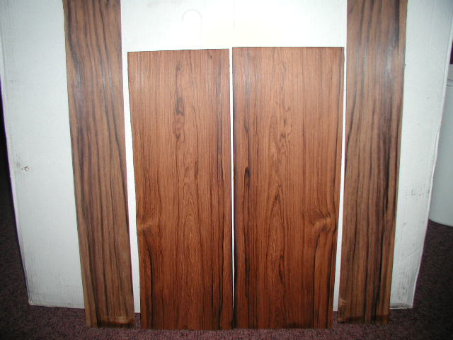

John - Here's one of the first things that went through - one of two sets of Mad Rose from Vikwood - the stuff that comes really rough and ugly looking to start. Really have to go light and slow, else the paper loads up right away.
Next I have to sand some Bubinga and Padauk that I resawed myself.
